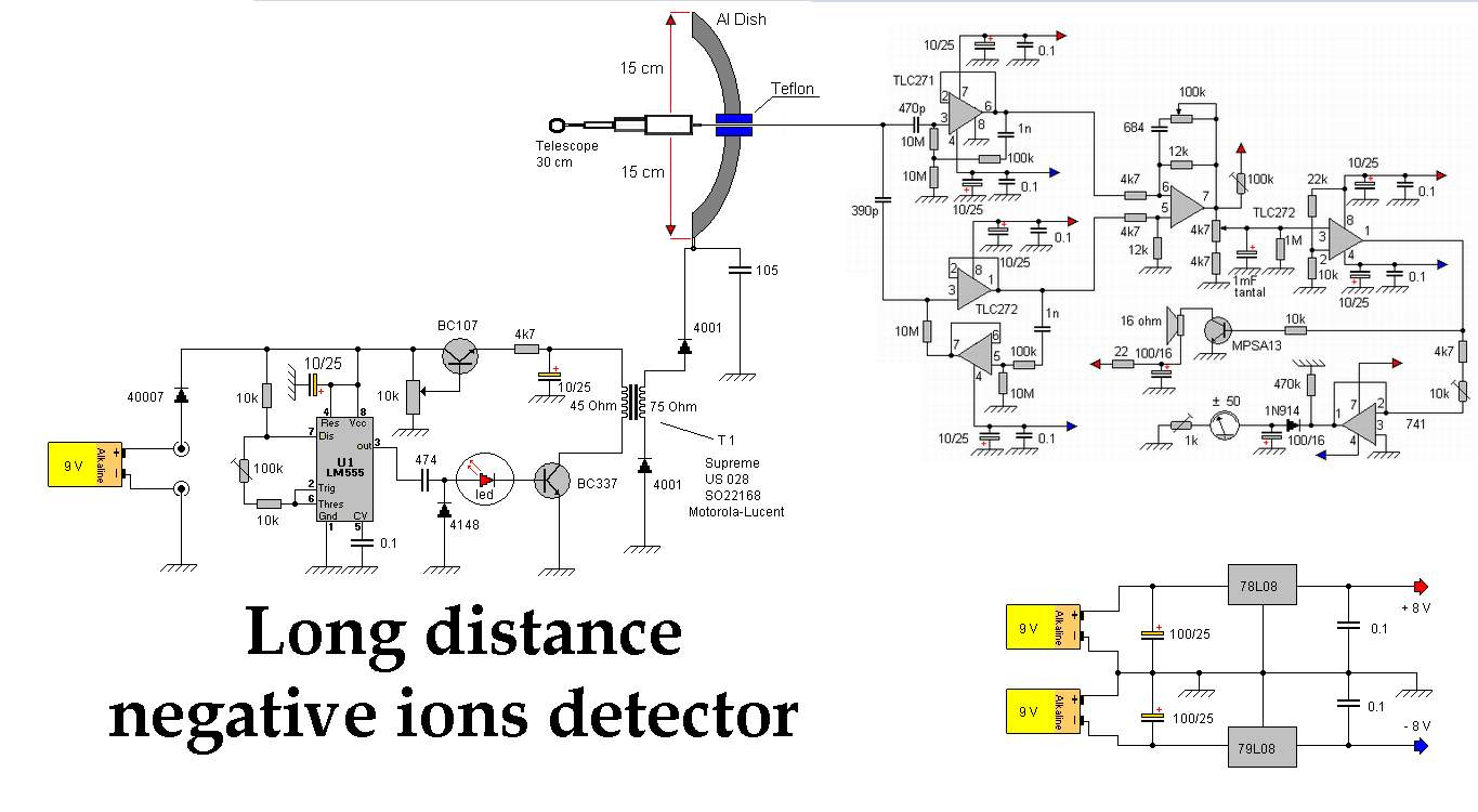

This thread is about the Negative Ion Detector circuit schematic that Ivconic posted. This circuit is re-posted below, and I have restated some of the significant statements about this circuit made by forum contributors. There is enough information in these pages to build a working model based on Ivconic's circuit, as well as to make modifications to the circuitry for enhanced performance.
Some important features that make this machine different from some other LRLs are that it is one of the few LRL designs I have seen that uses no "bait charge" or sealed chambers, while using an electronic circuit that is designed to sense and amplify a signal using standard electronic circuits and principles. I see no place where there are wires terminating on surplus or non-working circuit boards, and there are no circuit components not electrically connected, and only glued together.
I am totally ignorant of how detecting negative ions can help anyone locate distant buried treasures. But I can discern what the apparent purpose of the components in these circuit diagrams are. What I have to say about this device is based only on my rudimentary understanding of conventional electronic circuits and the known physical laws of energy and matter. There may be much more to the principles of how this machine works, unknown to me or other scientifically minded persons educated in the classical method of understanding the world around us. Therefore I make no claims as to how this device may work or not work for locating remote treasures. The following is only my understanding of what I would expect to measure with this machine:
It appears to me that if this machine is properly adjusted, you may expect negative airborne ions in the general vicinity of the dish will be attracted to the dish. And upon contacting the dish, some of them will become neutral. This should also be true of negatively charged dust and aerosol particles suspended in the air around the dish, which may end up becoming a thin film of dust on the dish. At the moment that any negativly charged particle contacts the dish, there will probably be a minute pulse of electricity accumulated on the antenna (or maybe not, depending on how well the circuitry works). I imagine that any minute charge on the antenna would be induced my the electrical or (indirectly) by the magnetic properties of the charged particle changing from a positive to a neutral charge. I presume sub-atomic particle and wave theory is involved in explaining the energy coupling to the antenna. In any case the amount of signal that appears on the antenna is extremely minute, and it would take a lot of ions collected to become measurable. Assuming that the negatively charged particles are being neutralized by the dish in a non-uniform pattern as the dish is moved around, then the amount of charge sensed on the antenna would vary depending on where the dish is moved, and on the composition of the air around the dish. ie: if you move the dish close to an ion source (like a high voitage air purifier, or a flame or other source of negative ions), then the amount of signal will be different than from the previous location. The minute variation in signal is sensed and amplified so it can be seen on a meter or heard from the speaker. The circuitry also has 3 adjustments which allow the user to adjust the output to a null point with a high degree of percision in a widely varying environment of local airborne ions.
As far as I can tell, this device is measuring the the antenna's reaction to the concentration of charged particles in the nearby vicinity of the dish (nearby meaning within a foot or less). If there is some mechanism by which remote treasures are being located, I am totally ignorant of that mechanism.
I welcome any explanations from experienced users of LRLs about how this machine works, and any corrections in the theories that perhaps I am ignorant of. So far I have heard a number of conflicting explanations from different proponents of LRLs. I will have no arguments against any theory, but I may have some questions if I hear explanations that I can't understand. (I already heard the theory that these devices are used soley for detecting gravity and seperating a buyer from his money. No need to elaborate on that, because I understand that principle complely).
The following post after this is Ivconic's circuit and my commentary on the components of the circuitry.
Old 02-23-2006, 11:01 AM
Default Ivconic's Negative Ion Detector Circuit
The Circuit below is what Ivconic posted as a "working LRL". Since it has some standard electronic circuitry, I will give a brief overview for those who are interested. Keep in mind I am not an electronic technician, and I may make some errors.
The basic purpose of the circuitry is to charge the dish positively, and sense minute electrical variations that are picked up on the antenna. The electrical variations sensed on the antenna are amplified and sent directly to the speaker. This means you can hear only variations in the audio range that are sensed on the antenna. The meter is wired to show the amplitude of the audio and non-audio signal variations. There are 4 controls which allow you to adjust the amount of charge on the dish, and to adjust the sensitivity and range that you are sensing on the antenna. This means that you are only measuring relative changes in the signal picked up, not the absolute amount of signal. However, if the controls are left at the same settings, you will see the relative change in signal from one sensing location to another, and from one point in time to another.
Starting with the U1 LM555 at the lower left, all the circuitry around this IC is an oscillator that supplies ac power to the Motorola-Lucent transformet (this is a transformer from a modem card). The secondary side of that transformer is connected so as to put a positive charge on the dish. The 100k potentiometer to the left of the 555 probably adjusts the oscillator frequency. If so, it will ultimately adjust how strong a charge is sent to the dish. This entire charging circuit and it's oscillator has it's own dedicated power supply which is isolated from the remaining sensing circuitry. This is most likely to avoid sending interference from the oscillator to the sensing circuits. I suppose the dish charging circuitry is turned on and off by removing the 9v battery to the left, but a switch could be added to disconnect the battery.
The reciever portion starts with the 30 cm telescoping antenna in the dish. It is shown connected to a wire that passes through a teflon bushing in the center of the dish. It should be said that teflon is one of the best insulators known, and the use of teflon may be crucial for top performance. The physical dimension of this teflon bushing may also be important depending on what voltage the dish is charged to, and if there is an ac frequency component on the dish.
Next we come to the sensor circuitry. (I presume this circuitry is isolated and shielded from the oscillator and dish. All of the sensor circuitry is powered by the two 9v batteries shown at the bottom right. The two voltage regulators provide 8v positive, 8v negative, and a ground. The sensor circuit is also turned on and off by removing the batteries, but a 2-gang switch could be added to turn it on and off. When we trace the wire from the antenna to the 3 ICs to the right, we see the signal is feeding into a 3-IC circuit whose output is sent to a differential amplifier.
Take note, that the differential amplifier has 3 potentiometers, one to control the feedback, and two that adjust the output signal that feeds to the next amplifier stage. This is where the sensitivity and sensing range of this machine is adjusted. After passing through the next amplifier stage at the right, the signal branches toward the speaker and a meter. The speaker has a small power transistor driving it, while the meter has an IC with another adjustment on the input side (appears to be a gain control to keep the meter in the desired range).
A final note about the differential amplifier circuitry: The 3 ICs that initially sense the antenna signal are designed to create a differential signal from the single signal on the antenna. The lower 2 of these 3 ICs, may create a short time delay in addition to inverting the polarity of the signal, depending on the values of the components around the IC. If this is true then this delay can be thought of as a phase shift for any frequency that may be picked up on the antenna, and the degrees of shift would be defined by the frequency sensed. If this portion of the circuit was intended to act as a delay, then it may have a significant influence on the operation of the LRL.
If anyone was to build this circuit, I suppose the mechanical considerations would be to make sure the dish and antenna assembly were sturdy enough to withstand whatever use you put the machine to. I imagine the balance of the finished machine is also important. This machine would be very lightweight, with the heaviest component being the 3 batteries and the meter. The electronics could probably be mounted inside 2 small aluminum boxes attached to an insulator on the back of the dish, and a handle attached to the bottom side of the boxes.
Electrical considerations revolve around the fact that you are measuring minute electrical variations near a charged dish. I would think it is important to wear non-static clothes (no synthetics -- 100% cotton), and keep any other objects that collect static charges away from the machine. Also, I would mount the dish-charging circuit in a seperate metal box from the sensor circuit. And ground both boxes to the sensor ground, while keeping the dish-charging circuit isolated from the box that it is mounted inside. If the charging lead that connects to the dish is longer than about a centimeter, I would shield it with a shield that connects to the box ground.

HI everyone
suggest this link for better knowledge of the electrostatic/ion fenomenon:
http://www.ece.rochester.edu/~jones/demos/ahern.html
http://www.wenzel.com/pdffiles/cloud.pdf
http://amasci.com/electrom/sas51p1.html#electro
http://www.imagineeringezine.com/e-zine/efield.html
http://www.corp.direct.ca/trinity/iondetector.html
I think that only an E-field may go for 10 meters or plus and ions near the detector are affected by this E-field

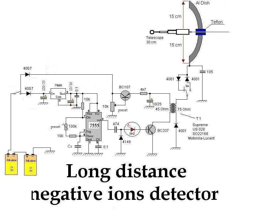

Ivconic, welcome!
Some considerations: the 555-oscillator requires work with voltage regulator. I think 8 volts is fine. So, two 9 V alkaline batteries needed for mantain large time in operation.
Now the transistor is connected to 18 V, no in regulator part for to prevent inestabilities.
Also replace the common 555 by 7555 wich drain less current. Cx is for calculate the desire frequency, believe 100 between 400 Hz is good. The key command another diode for detect positive ions. Dish polarizate negative = attract positive ions. Dish polarizate positive = attract negative ions. The batteries must be independent to this stage of the sensor-amplifier stage.
Any idea? Is correct this?

I think you have to reverse polarity of the other diode for detect positive ions!

if the purpose of the transformer is to raise the oscillator voltage we can use 2 x 9V batteries stabilized by a 7815 regulator without the transformer...

Franco is right. There is no need to add the voltage regulator. The original circuit has a transformer which raises the voltage above the amount seen in the output from the 555. If you wish to change the polarity of the dish, then connect a 2-gang switch that will reverse the polarity of the 2 4001 diodes in the original circuit.
The power consumed by the 555 can be reduced by using a cmos version of this IC. The oscillator could also be built from a cmos quad inverter and a resistor and capacitor. I expect the inverter oscilator would use even less power if the capacitor value was small and the frequency was in the low audio range.
My best guess is the frequency does not matter except it should be at a frequency that is close to the resonant frequency of the transformer/capacitor to the right. as the frequency of the oscillator is shifted away from the resonant frequency, you can expect the amount of charging to the dish to drop off. The 100k potentiometer next to the 555 is for making adjustments to the frequency for tuning purposes. The resultant voltage can be measured between the dish and ground rail with an analog volt meter. If this frequency is in the audio range, then there is a good chance you will hear it in the speaker. I presume this is not desirable, and it is tuned to a frequency outside the audio spectrum.
If it is desireable, the are are a number of ways to charge the dish to a higher voltage using the same 9v battery, and even send a very pure dc charge to the dish if necessary. But I have no knowledge if doing this this would improve locating treasures with the detector.

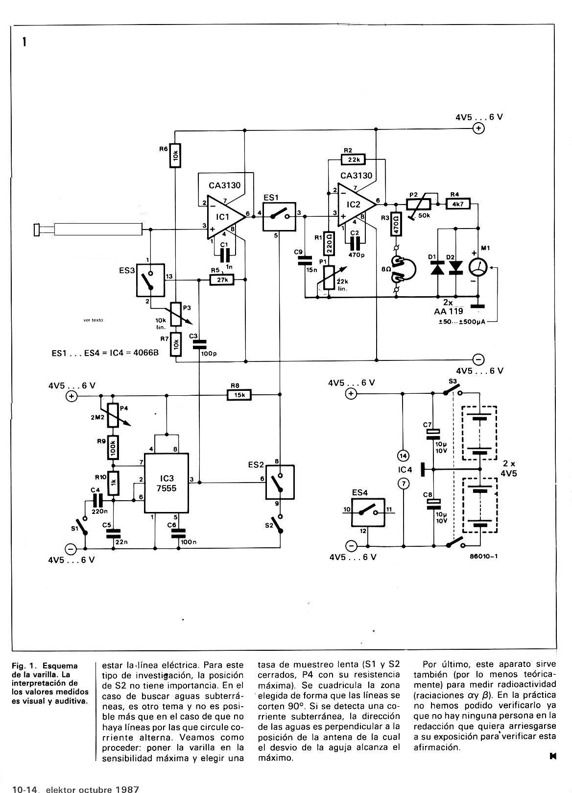

Elektor's article (1987) about ionic detection for water, somebody maybe has in English. The article refers you can use a plate or telescopic antenna for this. The designers of this device assume that can find water IN MOVEMENT (subsurface), the only kind of water detectable by INTERCHANGING of ions.
The oscillator, through the 4066 transmit the frequency to the antenna for to discharge excesive ions arrival. The 10 k pot provides a kind of threshold and works as sensibility. Key is for detect water and other for electricity in walls. At more low conmutation via 2M2 preset the sensibility is better, this is at more low frequency. C9 is a kind of memory for the signal to compare, require good quality capacitor. Downloadble complete article (Zahori.zip) here: http://www.mytempdir.com/472871
Maybe somebody can translate for all, maybe somebody has the English version.

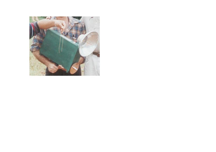

Say Esteban, was that picture on the Mineoro thread with some guys with an ion detector your dish antenna ion detector? And was it the hopped up Elktor circuit. So have you really found anything with it???
I would venture that a simple tin can would server just as well to replace the bulky dish antenna. It could even have a fan in the back of the can to suck air in. That way the detector would not be subject to wind and air movements so much. Some of the commercial ion detectors use this principle. That big dish antenna is cumbersome in the field.

The picture in Mineoro thread is a machine type high-voltage, but in this case the high voltage "emerge" from the sharp-end of the central solid bronze antenna. The round copper disc is the "receiver". Incredible, but this machine works better near high voltage lines. No many technical details have about it...
The original Elektor 's "water finder" (in Spanish "ZahorÃ*") suffers some modifications. I added two more lateral antennas to 0 V, and use an only sensibility control, the 10 k pot. This circuit work fine at 4.5 V, 1.5 V AA batteries, dual +/- 4.5 V.
The audio output connect to an audible signalizer type bip-bip. So, convert any "bad" tac or tic or etc. in a bip-bip.
The antenna has not direct connection with the IC, I use 100 pF.
Yes, sure, also you can find buried long time metals with it.

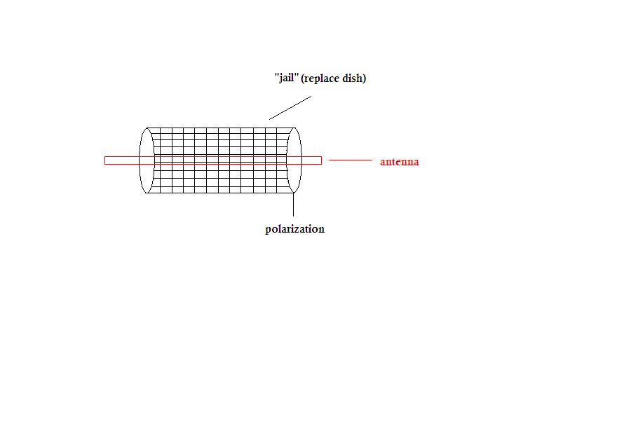

Here a classic idea of antenna for ions detection. For replace the both lateral telescopic antenna in Zahori or for the Ivconic's project.

Thanks for reply. Your "classic" ion detection antenna is basically the same as my suggestion to use a tin can with an antenna in the center. The tin can is polarized to collect the opposite of the ions the central antenna is collecting that goes to the analysis electronics.

I have read all post so far. First, a lot of thanks to J Player for opening
a new thread. I do agree absolutelly with that. J Player's notes,suggests and
ideas are more than welcome and I could not do anything else but agree and thanks!
Some hints:
* For dish I can advice only Al or Cu.
* 555 to replace with 7555 is just fine.(due to power consumption)
* freq.of 555 is to be tuned a lower than 1khz.
* stabillity is not very important due to purpose of polarisation of the dish,
that's why is 555 choice,dish need some potential and freq. can vary a bit.
* transformer is not only for rising voltage but as a galvanic isolation and
band-pass too.
* dish is better than cage due to wider range of rejecting,although a cage is
very nice solution if you want a narrow angle of "scaning".
"Inside this box you should keep the circuit with the differential amplifier
as close to the antenna as possible..." J Player's note
* This is crucial !!! I do agree 100%. Otherwise all You pick up is a noise!
that's why teflon is used.It should be a teflon holder for antena and pcb
at the same time! No wires at all in between! The rest of the box may be
Lexan or metal.
"I think it's important to define what is the audio to loudspeaker, as there
is no audio generator and then signal comes from antenna. The 1 mF tantal
capacitor at the out of differential stage has a great value and then only
very low frequencies can arrive to loudspeaker, I suppose a sound like "tac".
Very strange the imput stage as on the contrary of instrumental amplifier it
has a single input, also doubbled, and a differential output. I think the
voltage on the Al dish it's not a perfect DC voltage but it has a little
ripple of the oscillator frequency and this is the "carrier" of signal
received." FrancoItaly's notes
Ciao Franco, come e sta? I guess that's all from my Italian!
Well You have right at some points. Audio is "poor" a bit, but enough.You can
mod it if You want. The 1mF tantal is a filter. "Tac" is supposed to hear and
it is allright.Input is ultra high impendace, only way to collect some ions.
Input has a "double" or "twins" but with different level of amplifying, think
about that! Both are leaded in to diff. amp.and only a slice shift You hear
in a speaker.About "carrier", well You might be right.I was thinking to put
some extra filter on it.Open for ideas.

About "jail" or "cage"(as I named it), yes, but it is very narrow and You have to
use a fan. Fan, from the other hand, can produce some noise to input....
It will need some extra electronics to calm down that noise.But in any case,
"jail" is nice too.

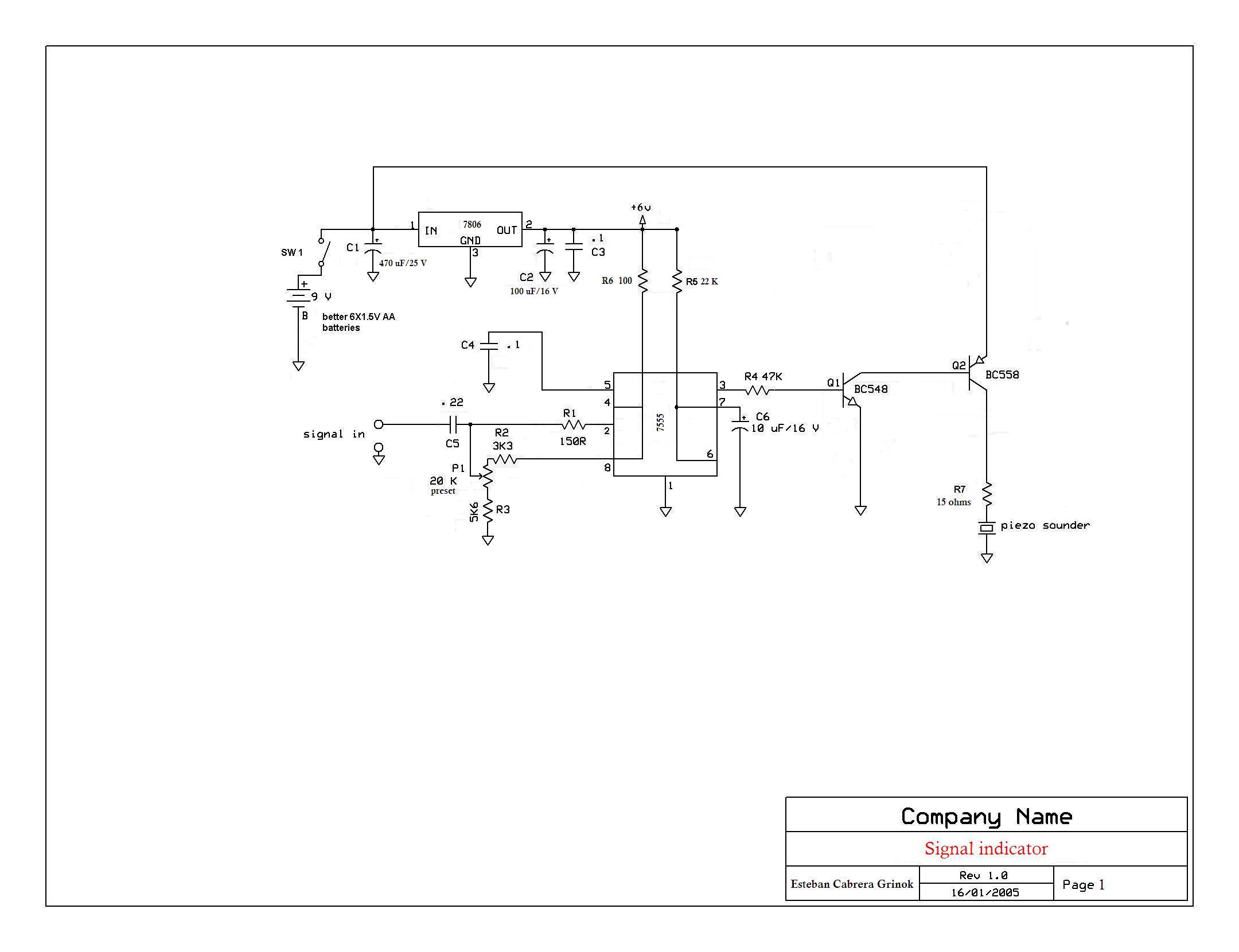

I use this very stable circuit for any gadget. Is for convert the ugly sound or minielevation of audio in nice "bips". This is for ALL use you want.
The 555 works as comparator. In abscence of any signal (this is, all the stages off) connect this circuit. Whit the preset, adjust in the more sensitivity point —this is, near the continuous bips— and retire a very little. If sounds at the moment of the connection, adjust it in the more good level point. The 22 k resistor and the 10 uF cap are for short timming of bips.
The piezosounder is the type that include internal oscillator.
I have built many of this with 100 variations, but this is one of the betters.
Of course, with the preset you control the sensibility you want.

2. The TLC271 and the first tlc272 have unity gain and the first half of the other TLC272 has a gain of 3 about. I believe that the first stages must have more gain.
3. If i use a bakelite feed-through capacitor instead for teflon is there any problem?
Can i detect iron or other metals with the ion detector so to be easy to test and play with it?
I wait for your opinion.

Hi Esteban. Why there are two dishes?

A few of thoughts come to mind about modding this circuit:
1. We know the 7555 can be subsitiuted for lower power consumption in the charging circuit. Frequency is not critical, below 1khz. Does anybody know if it is desirable to have clean DC charging the dish? Or is it better to have this 1khz ac frequency component sent to the dish? There are some easy circuits that will remove most of the ac from the final charging to the dish if this is good for improved performance.
2. Is it desirable to have even higher voltage on the dish? If a higher voltage is good, then a simple diode/capacitor circuit can be used to double, triple the voltage or more. Very low cost.
3. For the antenna signal amplifier, the TLC272 has extremely high inpuit impedance because it is a cmos device with field effect input gate. The next 2 stages of differential amp and linear amp are a second TLC272 (each TLC272 has 2 cmos op amps on the chip). There are several similar cmos op amps in this family starting with the low-cost TLC272 to the TLC277 for high precision. All these devices are capable of taking a very small signal and amplifying it with a minimum amount of interference from the power supply and very low power consumption compared to bipolar op amps. This is why they are the preferred choice of op amps to process the weak ion singnal on the antenna... they give you the best chance of listening to this signal with the least amount of interference from outside noise. If you want to make a substitution, then use another Cmos device or FET device in order to keep the input impedance very high. A simple cmos inverter like the 4001 can be used as a substitute and wired with feedback to act like a linear amp with hand-picked resistors and capacitors to accomplish the same results as the TLC272, but it will be a more simple design. The 4001 inverter version will have the same noise rejection properties as the TLC272, but not the refinements and linearity of the TLC272 op amp version. It may turn out that the 4001 version is adequate, and no need for advanced op amp version of Cmos.
There are also other cmos and FET devices that could be substituted in the signal amplifier stages. If you want to know a good substitution, then look at the cmos and FET catalogs, and find op amps and darlington amps that are available. All these devices consume low power if you don't connect a power hog load to them. And this circuit does not show any power hog load in the output of any of the signal amplifier stages.
4. Ideally these antenna signal amplifiers should be close to the dish and antenna. You may even make a small 30cm circuit board to hold these cmos amplifiers, and connect it to the antenna connection at the teflon bushing. Then put a wire mesh or metal box around this circuit board, and send output wires to the speaker and the meter. In order to keep things simple, the transistor and op amp for the meter and speaker could be mounted on the back of these devices. This way, the sensitive cmos parts could be kept seperate from the higher power noise-maker amplifiers for the speaker and meter.
5. Answer about audio at the speaker: Any audio heard at the speaker will come from one of three sources. 1) If ion signal is being collected on the antenna in a wave pattern that is in the audio range of frequency (20 hz to 15000 hz) then you should hear this sound on the speaker. 2) Electronic noise from the circuitry may be audible on the speaker if this noise gets into the signal circuitry. This noise includes the 1khz charging oscillator frequency, and elecrtonic noise from transistors in the meter and speaker amplifier circuits. 3) Atmospheric interference, which could include who knows what? Could be anything from static electricity to sunspots causing ionisphere interference, or friction from tires rolling on the road sending out static charges. The electronic circuit noise can be minimized by using shielding around the signal amplifiers, and by keeping the connection wire very short between the antenna and the cmos op amps.
6. Final thought is a question for anyone who knows: The antenna signal feeds into 2 op amps which send out a differential signal into the differential amp. But these 2 op amps also have a 3rd op amp shown below in a feedback loop on the lower of the 2 op amps. What is the purpose of this feedback loop? is it only to create a delay that helps reverse the polarity of the lower op amp? Or is it to also act as a filter for certain frequencies seen in the antenna signal?

I think you can use TL081 and TL082 or 3 X CA3130 that have similar features. The first high impedance stage use bootstrap technique http://web.telia.com/~u43200663/bloc...tstrapping.htm the bottom stage with 2 OP (TLC272) has a greater impedance than the TLC271 amplifier, and is also greater the RC constant. I think that the differential amplifier only responds to variations of signal input, when you move the instrument in different site, and like a "motion metal detector" the 4K7 potentiometer is the preset "tuning". There is no need of retuning push.

The Led in input stage serves to visualize the battery charge, but I think is better to use a 78L06 for voltage stabilization with 1/2 LM358 used as comparator + Led and to use the other 1/2 LM358 as oscillator instead LM555. The voltage on Dish can be changed by the 10K potenziometer and I think we can use other types of transformers, but it's necessary to know the highest value of voltage on Dish, on this site http://www.techlib.com/science/ion.h...tter%20Version the author uses 45 V for collecting ions and we can use a transformer with a ratio of 1/5 or 1/6.
