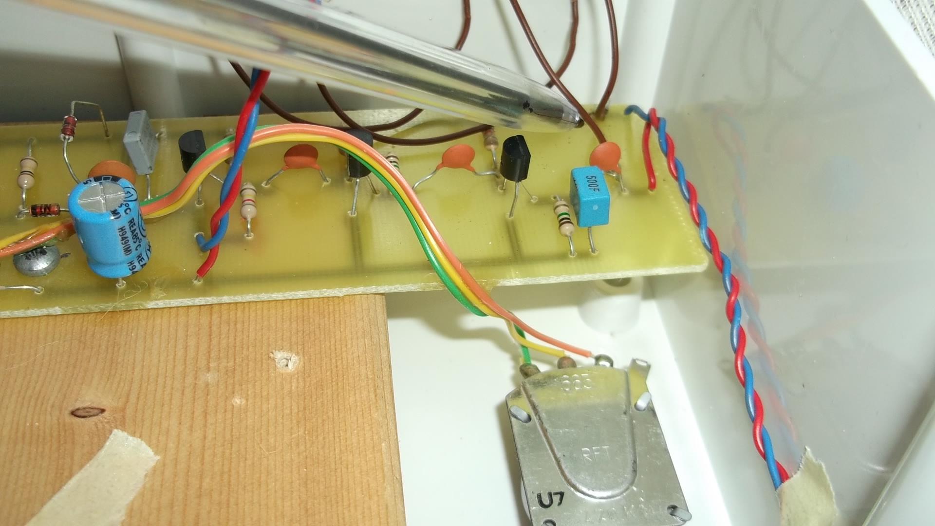

one little mistake, no need to cut the coil cables,just cut the capacitor 6n8 and connect the selector tho the PINs in the circuit.
Here is for adapt to PDK-2.1 ,two diferent selector according the problems found in each country :
Its not difficult to build this simple selector ,need only to cut the original 6n8 cap. that is in paralel with the RX receptor coil,and use the cuted legs of the cap. to solder the SELECTOR wires.
In the photos i show the place where 6n8 was removed to give place for selector wires.
Any question cotact my email or send PM
