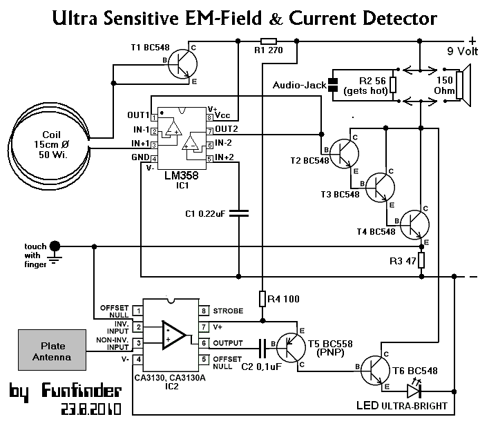

Lightbulb
Guess I solved the riddle:
It is always an "inbetween thing".
In usual MDs the metal objects comes inbetween the action-radius of the coil(s) or there field(s) and with special detectors it also can only work if there is this special situation.
It was proven tested and possible that an electrostatic detector also finds metal if it's inbetween the e.s.-field.
And that helicopter my Detector #2 received also was inbetween such an e.s.-field of earth and sky. It doesn't have to directly above me because of its very strong power, like a flash in a thunderstorm also can be far away and still got recognised.
It is very interresting that the Mineoro doesn't work at high air-humidity (and also soil humidity???) because usually radio waves have no problem with it. You even can watch satellite TV if it's strong raining or snowing - there is only some loss in signal-strenght. And of course you also can listen to the radio if it's raining.
What really is effected by humidity is electrostatic and high voltage.
Let's assume the Mineoro measures the difference between the nearby static potential of ground and sky.
Even if it works different - and we better find an all time working device - with this method it should be possible to detect metal objects only with passive reception.

Hi All
For measuring a static voltage (perhaps a part of "phenomenon") it's necessary an alternate B field that acts as antenna, a sort of "chopper" system that overlaps tha DC field, otherwise it's very difficult to meausure a little change in the static DC field. There is a change if we lower or raise the antenna or we change the inclination and perhaps it is the Sky or compass effect
Best regards
Hmmmm...
I don't believe it.
I don't think your circuit can detect changes of electrostatic field that are caused by a helicopter flying at a distance of 1-2 Km. I believe your detector can detect static fields maybe up to 10 meters for very large field strength (lightning bolt strikes the ground at 10 meters distance, for example). But we know the inverse square law will quickly diminish the detection distance for even large fields when they are more than 1 km distance. You guess you solved the riddle because a helicopter more than 1 km away interrupted the field gradient between earth and sky?
Are you serious?
Do some testing on your detector. Why not see if it is sensitive to large acoustic vibrations? Take it to the side of a railway crossing while a train is passing by and see if the train sounds cause the wires to rattle enough to make it beep. Put a Faraday shield over the detector so it cannot detect static fields, and will only rattle with the train sounds. My guess is it will beep in unison with the clanging sounds of the train.
We hear long diatribe about how better testing is needed to learn how LRLs work, but when we get to the final analasis, we see you are content to "guess" you solved the riddle by choosing the most convienient theory you have in mind to explain what your circuit is detecting. The fact is you don't know what it is detecting.
From what I read so far, my best guess is you built a static field detector that is good for a few meters at best. But because you have loose wires on your high impedance inputs taped together inside a sound box, it is probably also sensitive to acoustic vibrations. However, this is only my guess, because the critical testing to determine what the circuit is detecting has never been done.
At this point, my assessment of this LRL is it is a very good gizmo that is ripe to mass produce for a toy for children to experiment with and dream about mysterious forces it can see. Maybe it detects ghosts and Jinns as well as static fields. But nobody knows for sure. This is the beauty of it. It can be represented as a treasure finder, a long range aircraft detector, a static field detector, a spirit finder, and a detecftor of anything else you can think of. If you took Carl's test to locate a Jinn hidden behind one of 10 trees spaced 3 meters apart, you could claim the Jinn moved as soon as you located him! Who could prove you wrong?
I suppose it is a good strategy to claim you guessed how the circuit works when you did no testing that shows any evidence that your guess is correct. It is even better strategy to compare your detector to Mineoro, which is completely different in design, components, and operation. This has the effect of elevating your taped-together high impedance op amp to the status of the Mineoro regenerative receiver and strange ion chamber with an unusual antenna system (a questionable status level). Somehow, I don't think a taped together op amp is comparable to a Mineoro LRL. I think it is comparable to a high impedance op amp connected to an antenna and loose wires inside a sound box.

Funfinder!
My congratulations on this your detector. I like it. I think we need to work on its further development.
I would like to pray, if not a problem, the following information:
1. Induktivity and resistance of the antenna 15 cm;
2. Cross-section of copper wire in millimeters, from which the antenna is made;
3. Resistance Plate antenna;
4. Dimensions Plate antenna;
5. From what kind of metal is made Plate antenna;
6. Are the values of resistors on your schedule in ohms (ohms) or Kohm, and
7. Have you used an active speaker with its own audio amplifier?
Many thanks you in advance for your response!
Good luck in future investigations of wishe!
Zocky-Zocky
  #62
Old 01-30-2011, 08:09 AM
Funfinder's Avatar
Join Date: Feb 2010
Posts: 482
Thumbs up
Hi Zocky-Zocky!
Thx for your interrest but for now I have no idea how to improve this stuff. The EMFAD detector uses passive long wave receiver that can find EM-field concentration but what we'd need is to get the "reflection field" of metal objects inbetween the underground electrostatic field.
Modern earthquake-warners can detect the current of bedrock if set under friction or pressure like it is used in piezo-lighters but yet I have no idea how to use this for metal detection.
Answers to your questions:
1. don't know but these values are not important in this case
2. 0,25 or 0,30 mm
3. no idea
4. ca. 25x15cm
5. iron tin, but you can use anything
6. if there's written no k the ohm values are below 1000
7. the activ-speaker has an amplification, but not alot
btw. if you're using a larger plate antenna you can get even more sensitivity. Good luck with your experiments!

Good luck with the circuits - with building, testing, analysing and whatever.
And no stupid comments!
Thanks for the design, the one with integrated circuit you set up? Is it the same circuit at the beginning of the post?
Does the box have to be wood or other material? I'll ride because I believe in your technology, hugs
  #67
Old 12-17-2019, 11:11 PM
racminer racminer is offline
Join Date: Dec 2019
Posts: 3
Thanks for posting schematics.
I don't quite understand how your IC1 LM358 is used ... pin2 (IN-1) and pin6 (IN-2) are not connected to anything??
Thanks again.
Thanks again.
Still waiting for an answer.
