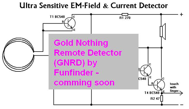

Exclamation Video Test Report
http://www.multiupload.com/H3AG7T6OWP
Yesterday finally the weather was fine so I could shoot the video. The plasticbag was hung on a bush after I rubbed it to my hair.
Detection distance is around 1m.
The unit received alot strange signals I couldn't always find out from where they came from. 300m away is a fastway and also a railroad.
But as you can hear in the second clip it also detects a helicopter. On the video it is perhaps just 400m distance, but I could hear it already much earlier - perhaps even 1-2km - directly and with the detector!
It sounds crazy, but it seems I received even some noises from a plane 3km above.
There also was nearby a very large iron object from an ex powerline-pylon fundament. I digged down 80cm a half year ago but left this solid with concrete connected stuff buried there. However, it couldn't detected.
And it made a huge difference how high I did hold the detector. 2m above the ground with reached arm the signals were "bombastic", while the border of detection are around 20-30cm above the ground.
It also made a big difference, if there were trees near or not (more near as 10meters).
Perhaps I'll publish the circuit for improvements because for now it seems not being capable detecting lta objects. But maybe there weren't just any near and iron does not working?
Actually circuit two should only became a very sensitive amp for the ferrite coil, but this still is not done yet.
I had no "concept" how those ferrites should distant detect metal so I focused on the sensitive receiver.
Well, I know how it would work, by very critical adjusted and powerful bfo - but I like to build some extra circuit for this. I guess at the moment the "pure" electrostatic detection still has to be modified.
Or the second possiblity: a long wave transmitting coil and a sensitive receiver where you can hear the frequency or modulation shift if some metal is near!!
It works already with the 100kHz wire-searcher transmitter circuit and some radio receiver but instead of the little ferrite antenna the transmitter should use a large coil. I have two of them, 1 works on 100kHz and the second with 150kHz - and the audible difference in FM reception seems better as AM.
I don't know if the mineoro detects plastic bags (I guess not!) but if there really is electrostatic involved at least it has to be even more sensitive - not only switching on or off style, but more slowly visible power or noise.
However, enjoy these absolutly authentic videos!
@ detectoman
the youtube md is IB design - it's called the "matchless detector" and completly different than mine. And the noise this homebrew makes is terrible!
Cool videos
The video of detecting the plastic bag appears to show you have detected a bag at a greater distance than most metal detector could detect a foil bag of the same size. I suppose maybe a 2-box metal detector could find the same distance or better, but few standard coil detectors can compete with that distance. Of course, the next step is to get your detector to detect a buried treasure from the same distance.
The other video with the helicopter is a bit confusing. We did not see the detector pointing toward the helicopter to show the directional properties, but we could hear some beeping that seemed to follow the acoustic sounds coming from the helicopter. Since we did not see where the detector was pointed, I am thinking it was probably in a stationary position resting on the ground, or on a table. And if it was detecting the helicopter from a distance of more than 1 Km, I am thinking it was probably not detecting the static field charge of the helicopter. So what did it detect?
Maybe stray RF in the air that had its reception interrupted by the spinning blades of the helicopter?
Maybe the internal circuit is sensitive to vibration, and the sounds are rattling the wires inside to cause beeping?
I have no clue.
Maybe time to connect the circuit to a scope and meters to see what it is actually detecting when targets are brought in proximity...

thx for your interrest and I will tell you some details:
I guess the size of the plastic-bag doesn't matters alot, it's the charge status. This was just a simple demo, because i rubbed it (for about 3-5 seconds) to my own hair. Assuming my body and head was already negative loaded from the ground the bag got positive charge.
But this bag discharges every time when the detector comes near by invisible ions through the air and also very slowly directly over the wooden bush that is connected directly to the ground.
the same way some sensitivity was lost while I moved the digicam closer to the detector, but not much.
btw. I missed taking my second electrostatic detector incl. 20 cm round plate with me so I could have checked the difference.
about the heli:
This was a very spontanous filming - but I did hold with my left hand the detector with plate in front into it's direction while searching where the helicopter is with the right hand and my eyes on the digicams display.
btw. I could encode the clips with divx4 fast motion so they just had around 10MB but I decided for better quality encoding 'em with xvid codec (66 meg).
AND - I forgot this to mention the last time:
I tested if it would receive the signals of the switched on coil of the Garrett Ace 250 but - absolutly nothing!
I also didn't hear the slightest AM radio broadcasting stuff.
btw. I could make the "shortcut a battery test". I don't remember exactly but some of the guys here got 1 or 3 meter "spark signals" with an 1.5v battery.
I guess those have been the motors ignition-sparks the detector received (similar like thunderstorm flashlights) because those create a strong EM pulse within a very large frequency spectrum, startin already at Very Low Frequency. You also can hear such stuff with AM radio.
Perhaps the helicopters engine iron block also works like some electrostatic antenna and radiates them to the outside.
btw. I guess the pure electrostatic load of metal - especially if buried in wet soil - is far to low for detection outside of the ground! At least with this actual circuit.
Maybe the Mineoro is sensitive enough but we don't know for shure what (if...) it really detects. For shure it doesn't detect the electrostatic load between earth and ionosphere where the metal object could act like a shield, reflector or irritator because otherwise it wouldn't detect it from a large distance. And the north-south directivity seems to has something to do with the distorted flow of the earths magnetic field.
The early units did use magnetic ferrite antennas - so this would match. Perhaps I better invent some magnetic field detector...
edit:
http://www.geotech1.com/forums/showp...4&postcount=89
ANDREAS @ "Alonso PD modification" wrote:
"A car run (out city) can detect up 200meters distance."
This seems to be the same like with my helicopter detection - of course because of it's extra position - even more distance.
This is cool - look what I've found by pure coincidence:
It's from mikebg -> Tech Forum -> "Beyond" TGSL
http://www.geotech1.com/forums/showp...01&postcount=3
I guess with very sensitive BFO that can distinguish the change of 1 or even 1/4 Hertz we have the best chance for "everytime usable LRL".
@ J_P
about the heli:
edit:
Hi Funfinder,
You cover a lot of details. I will address them each separately:
1. If you read enough of the posts made by mikebg, you will see he is not simply another EE who is experimenting with circuits. He is brilliant for analyzing the performance of different circuit configurations, and is knowledgeable of many obscure details of electronics theory and components that can have many EEs baffled. From what I see, he is fully competent to design and teach how to design and optimize circuitry for best performance, whether simple circuits or precision circuits in noisy environments. If you can define what exact kind of signal you are trying to detect and demodulate, maybe he can help.
2. This may seem silly, but who knows?
I read many posts by Mike(Mont) and hung which indicate that your mental state (radiasthesia) is important when detecting long range. Mike(Mont) has often written about the importance of meditation to arrive at the proper mental state in order to get good results for long range detection. Since you rubbed the plastic bag in your hair, is it possible your mental state is somehow influencing the detection distance of this plastic bag? Sure it sounds silly, but think about it. If your brain is producing theta waves, these are a different frequency than alpha waves or gamma brain waves which may be emitted after meditating. You are presuming your detector is only sensing the static charge of the bag. But is it possible that brain frequencies are causing variations in the charge that is transfered from hair to plastic? Is your circuit responding to more than simple static charges? If only we knew exactly what your circuit is responding to, we would better know what it is detecting. Silly as it may seem, there exists some remote possibility that Mike(Mont) could be right.
3. Since you could not detect the Garret metal detector coil, but we heard beeps when the helicopter flew by, we can speculate about the reason by using some known circuit features in the Garret detector. The Garret Ace 250 sends a 6.5 KHz magnetic signal out through a faraday shield. We can expect mostly a magnetic field at low VLF frequency. Apparently your detector is not responsive to 6.5 KHz magnetic fields. But we hear the beeps when the helicopter flies by which are beeping at the same times we hear acoustic sounds from the helicopter blades. This makes me think that maybe your circuit is responsive to higher RF frequencies, maybe LF, MF... up to GHZ that is used for mobile phones. If your circuit detects these frequencies of RF in the air, then it is possible the helicopter blades are interrupting a strong RF signal that your circuit has detected, and the fast interruptions from the rotating blades are causing your circut to make a series of fast beeps. I also considered that maybe your circuit does not detect RF. If this is the case, then maybe your circuit responds to slight mechanical vibrations. When we look at the construction method, we see the components are soldered point-to-point, and secured by tape. And we know there is at least one component that is very sensitive to the slightest variations in signal. We know that if the conductors are permitted to move slightly, the capacitance between conductors can change slightly, and perhaps could cause a change in the signal which is being amplified. We also see the coil is glued to a large metal sheet, which could act as a vibrating plate in the presence of an acoustic vibration in the air. If it also transfers this vibration to the coil, we may see some vibrating acoustic signal transfered to the circuitry. This may be especially noticeable if the acoustic vibration is resonant with a harmonic of the natural vibration frequencies found in the plate/coil assembly. Who knows? Maybe the whole box is vibrating from the helicopter sound, and causing the wires to rattle inside and cause capacitive beeps?
4. Looking at all the unknowns in your apparatus, I consider this circuit impossible to analyze. I think the best we can do is to speculate about unknown parameters. But it still is an interesting project.
I must admit, this is the first long range aircraft detector I have seen that does not use radar, lasers, or optical methods to detect the aircraft.

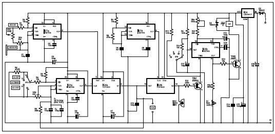

perhaps therefore later I'm priviledged for a special detector that only works extremly finetuned... diving deep into the microcosmos of "hyper minimal difference - arts"...
Hi Funfinder
here you are:
detector #3 DNC (Deep Nano Cosmos) detector:

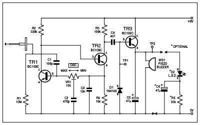

if previuos project is too complicated here you are very simple version:
  #44

these funny finder semms not possible zoom
